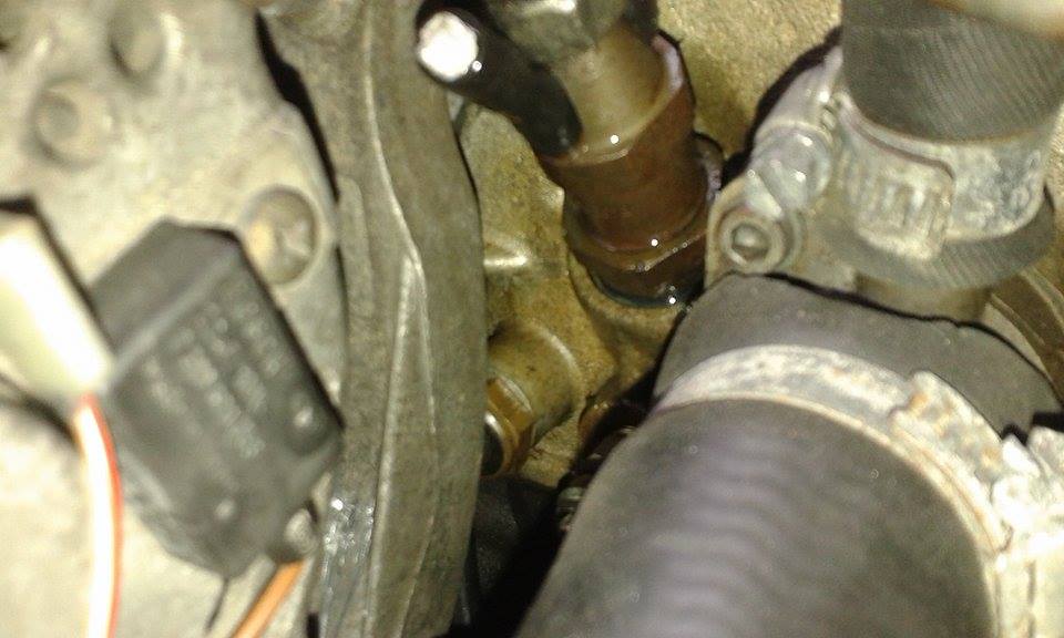

Diesel is leaking from my number 1 inejctor. It should not be any fuel line, but in the connection.
Is there any rubber/brass gasket or seal to replace? It should be rather easy to remove the injector.

Torbik bifogade följande bild:bild:

Yea there is a rubber seal that probably need to be replaced. Smile

I have never been a diesel man so: if I disconnect the injector I DON'T have to bleed the system as there isn't any pressure going to the injector? Does the seal have a specific volvo part nr?

Im unsure about the bleeding the system unsure. If you have run out of fuel in a diesel you have to bleed the system and the best way to do this is by the injectors it seems. Do you have a Volvo shop where you live ?. You better ask them about the partnr of the seal. In some cases of models you have a kind of metal ring that seals ( heat shield washers).
